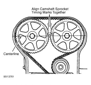

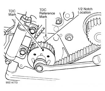

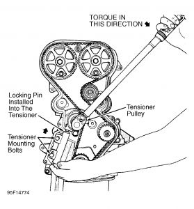

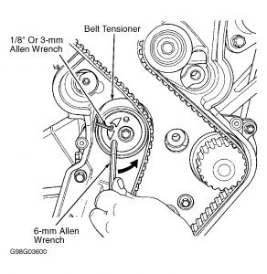

i would like the diagram for the timing belt on 2.4stratus twincam (timing mark)

Will these work?
