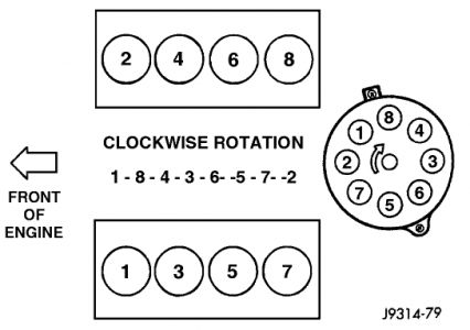

What is the firing oder for an 01 dodge ram 2500 with a v8?
Wednesday, July 21st, 2010 AT 4:24 PM
MECHANIC
75,992 POSTS
Firing Order - 5.2/5.9L V-8
