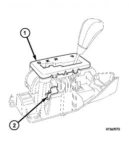

Wont get out of park. How do I bypass saftey switch? To drive to be repaired

If electrical failure BTSI on shifter can override park lock see diagram
