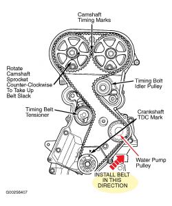

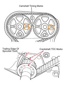

How to line up the belt with the top sprockets and the crank? Always seems to be a tooth off one way or another. THANKS
