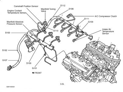

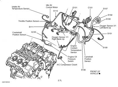

Where is the camshaft sensor located and how do you replace it? Thank you
Monday, March 15th, 2010 AT 9:15 PM
BMRFIXIT
MECHANIC
19,053 POSTS
Camshaft Position Sensor (2.7L)On front side of left cylinder head.
Camshaft Position Sensor (3.5L)On front of engine's timing case cover
