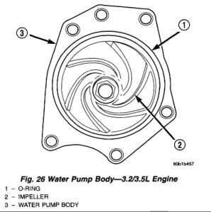

My car has coolant leak, I already replaced the thermostat, and it is still leaking. From watching videos on YouTube there possibly can be more like a faulty water pump or loss of pressure.

There are multiple areas that can leak, water pump failure is common. The easy way to find it would be to rent/borrow a cooling system pressure tester, fill the cooling system and put it under pressure. Then just look for the leak. It should be readily apparent.
This guide should help with the water pump replacement instructions below.
https://www.2carpros.com/articles/car-is-leaking-coolant
Check out the diagrams (Below). Please let us know what you find.

The water pump on all models can be replaced without discharging the air conditioning system.
WARNING: DO NOT REMOVE PRESSURE CAP WITH THE SYSTEM HOT AND UNDER PRESSURE BECAUSE SERIOUS BURNS FROM COOLANT CAN OCCUR.
NOTE: It is normal for the water pump to weep a small amount of coolant from the weep hole (black stain on water pump body). Do not replace the water pump if this condition exists. Replace the water pump if a heavy deposit or a steady flow of engine coolant is evident on water pump body from the weep hole (shaft seal failure). Be sure to perform a thorough analysis before replacing water pump.
1.Drain cooling system. Refer to Cooling System, Service and Repair, Service Procedures.
2.Remove accessory drive belts.
3.The water pump is driven by the timing belt. Refer to Engine for component removal to provide access to water pump.
https://www.2carpros.com/forum/automotive_pictures/12900_wp_5.jpg
4.Remove water pump mounting bolts. Note position of longer bolt for proper re-installation.
5.Remove water pump body from engine .
