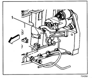

Working in the left fender area, remove the battery positive lead from the solenoid (1).

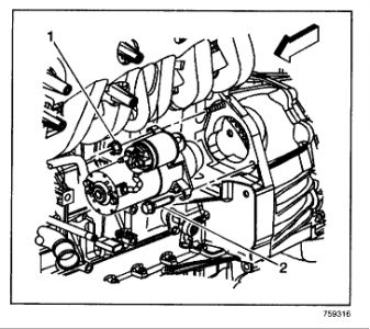

Remove the starter mount bolt and nut (1, 2).
Remove the starter motor.

Install the starter motor.
Install the starter motor mount bolt and nut.
NOTE: Refer to Fastener Notice in Service Precautions.
Tighten
Tighten the starter mount bolt and nut to 50 N.M (37 lb ft ).
Connect the positive battery cable to the starter solenoid and secure the cable with a nut (1).
Tighten
Tighten the positive cable nut to 9 N.M (80 lb in ).
