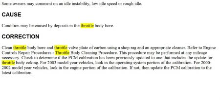

Where is the throttle positioning sensor located and what are the repair procedures.

With electronic throttle control, the accelerator pedal position sensor is behind the accelerator pedal. That's all I have at the moment.
I did find a service bulletin, about idle issues.
