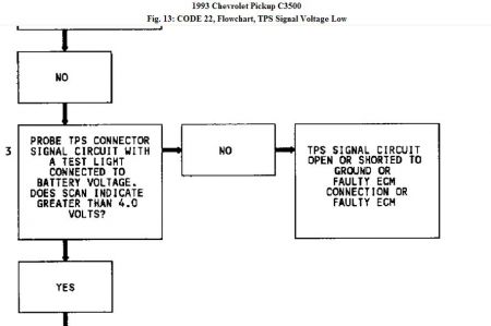

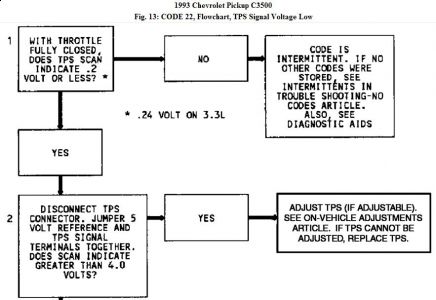

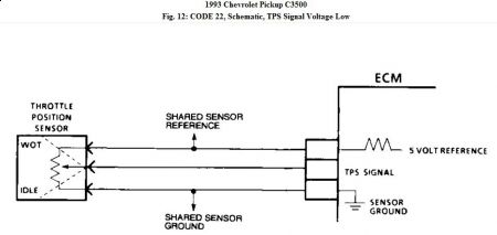

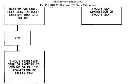

The engine of my 93' Chevy pick-up idles high. It also shifts hard. It started a month ago a couple of times, then ran fine for a while. It has started back up again. I get a code of 22. I've replaced the TPS and Idle Air Control valve. Didn't help. Any ideas?

Hi jsindiong,
Thank you for the donation.
Here are the schematics and flowchart for analysis. Go through them and see if it helps.

I actually fixed the problem this morning. I had been removing the fuse to the ECM and turning the key to run, thinking it erase its memory. Tried disconnecting the battery for a few minutes. Started it up and it runs just fine now! Yea!
