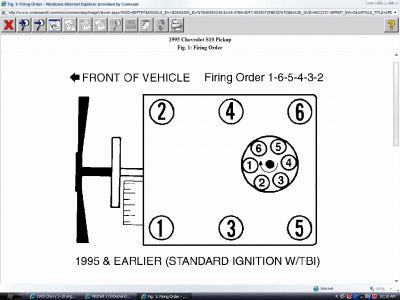

My son changed the spark plugs, dist. Cap and rotor and now it won't start before he changed them it would star but it skipped and blew black smoke when started and it skipped when accelerating. The firing order for the vortec 4.3 we have is 165432. Not sure if that is correct also

https://www.2carpros.com/forum/automotive_pictures/62217_Firing_order43a_1.jpg
https://www.2carpros.com/forum/automotive_pictures/62217_Firing_order43b_1.jpg
