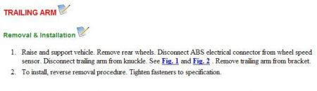

How do you replace a trailing arm?
Sunday, August 23rd, 2009 AT 8:21 PM
BLUELIGHTNIN6
MECHANIC
16,542 POSTS
Hello and thanks for the donation!
Below are the replacement procedures for your vehicle's rear trailing arm..
FIG. 1
FIG. 2
