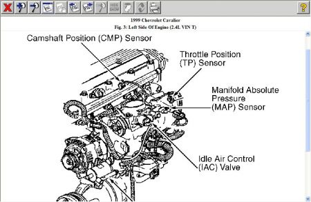

Where is the MAP sensor on a 99 Z24 Cavalier?And how do I get a hold of a wiring diagram for the MAP sensor?

The MAP sensor should read at idle 1.5volts on the return signal green wire and 4.5volts at wide open throttle .
