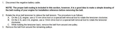

how do you loosen an alternator belt on a chevy 1998 cavalier?

That is a serpentine belt? does the tension pulley have a cavity in it? You use a rachet drive mechanism in the cavity and pull.
