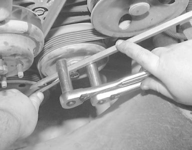

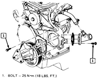

I need to know a free website on how to do it yourself to replace a water pump

For 2.2L engine, follow instructions below:
REMOVAL:
Disconnect the negative battery cable.
Properly drain the cooling system into an approved container.
Remove all accessory drive belts or the serpentine belt.
Remove the alternator and bracket.
Unscrew the water pump pulley mounting bolts and then pull off the pulley.
Unfasten the mounting bolts, then remove the water pump.
Using a putty knife, clean the gasket mounting surfaces.
https://www.2carpros.com/forum/automotive_pictures/261618_0900c152800c09c5_2.jpg
If the pulley turns when you try to loosen the bolts, attach sockets and ratchets to two of the bolts, insert a prybar to hold the pulley in place and loosen the bolts-2.2L engine
https://www.2carpros.com/forum/automotive_pictures/261618_0900c152800c09c5_3.jpg
INSTALLATION:
Place a 1/8 in. (3mm) wide bead of RTV sealant on the water pump sealing surface or install a new gasket, on models so equipped. Install the pump and tighten the retaining bolts to 18 ft. lbs. (25 Nm).
Install the water pump pulley, then tighten the mounting bolts to 22 ft. lbs. (30 Nm).
Install the alternator and bracket.
Install the drive belts or serpentine belt, as applicable.
Fill the cooling system to the proper level.
Connect the negative battery cable, then start the engine and check for leaks.
