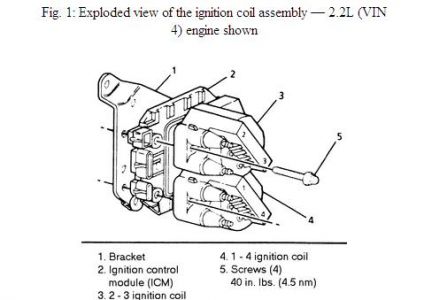

haveing problems getting my car to start was wondering where the ingnition control module was located to try and replace it

Hello, the ignition module should be under the coil pack. What kind of problems are you having?
