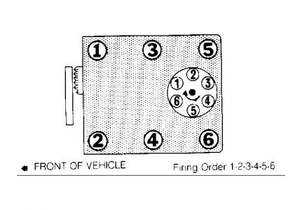

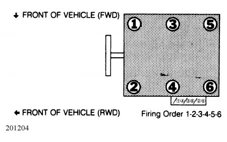

I was wondering how you can figure out the firing order because someone messed up my plug wires and I don't know what the firing order is.I know the book says its 1, 2, 3, 4, 5, 6 but im sure that isnt it because the car wont start. So is there an easy way to figure out the firing order?

What engine size? 3.0L, 3.8L etc?
-1
Monday, August 31st, 2009 AT 11:11 PM
AWSOMEDAVID9
  • 6 POSTS
Its the 2.8l
Tuesday, September 1st, 2009 AT 5:30 PM
BLUELIGHTNIN6
  • 16,542 POSTS
https://www.2carpros.com/forum/automotive_pictures/261618_Graphic_151.jpg
https://www.2carpros.com/forum/automotive_pictures/261618_Graphic2_17.jpg
