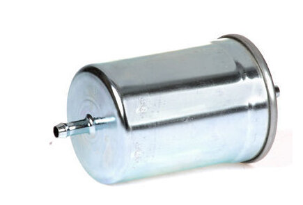

First question, how did you clean the fuel filter?
It is a sealed, metal, container. See image 2
I would suggest replacing it. An internal faulty/loose filter element could cause this issue

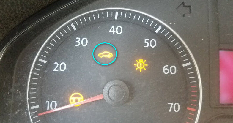

The other possible cause could be an immobilizer issue. Do you have a yellow immobilizer warning light on? See image below.
If so, next, try the spare key if your vehicle was supplied with one.
Also, I would suggest scanning the vehicle for possible fault codes.

Well, I washed it by running some warm water through it until the water was no longer coming out super nasty then I hung it so any remaining water could escape, and it could dry then we put it back on.
I do understand buying a new one would have been the best recourse and I did our purchase one just waiting on it to get delivered. I was just trying to see if cleaning it could be a quick fix while waiting on the new one to arrive.

But I was going through the trunk the other night and low and behold there was a brand new fuel filter in there the whole time. My husband installed it yesterday and it didn't fix the issue. And as for the immobilizer light it is not one of the lights that come on the dash.
