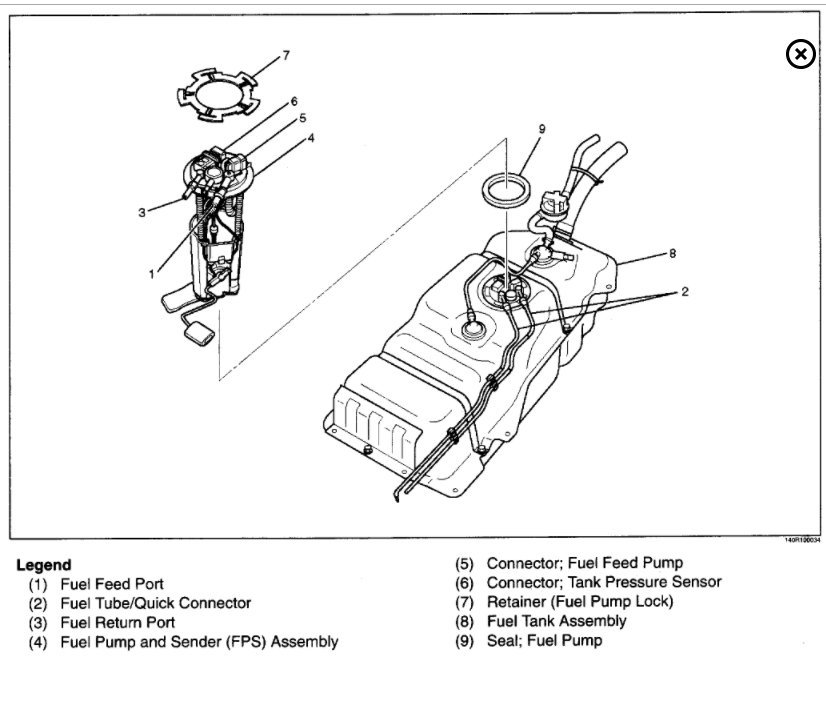

This sounds like a classic fuel pump problem, Here is a guide that will show you what you are in for when doing the job.
https://www.2carpros.com/articles/how-to-replace-an-electric-fuel-pump
Here is a diagram (below) of what it will be like on your car
