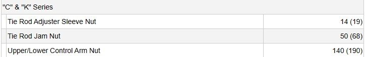

What’s the torque specs on camber bolts?
Tuesday, March 28th, 2023 AT 4:58 AM
BRENDON S
MECHANIC
653 POSTS
Good morning, Brad god,
Here are those torque specs you were looking for.
Thank you,
Brendon
