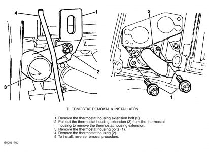

Can you please tell me where thermostat is located on 1998 cadillac catera?
Saturday, October 18th, 2008 AT 1:43 PM
MECHANIC
108,192 POSTS
Hi:
Follow the upper rad hose toward the engine. At the end is the t-stat housing. I uploaded a picture for you. I hope it helps.
