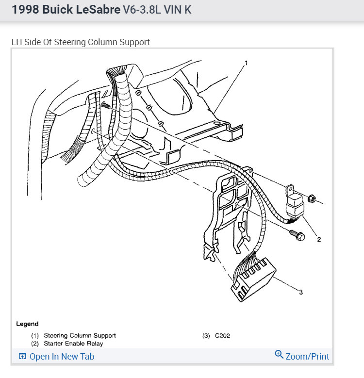

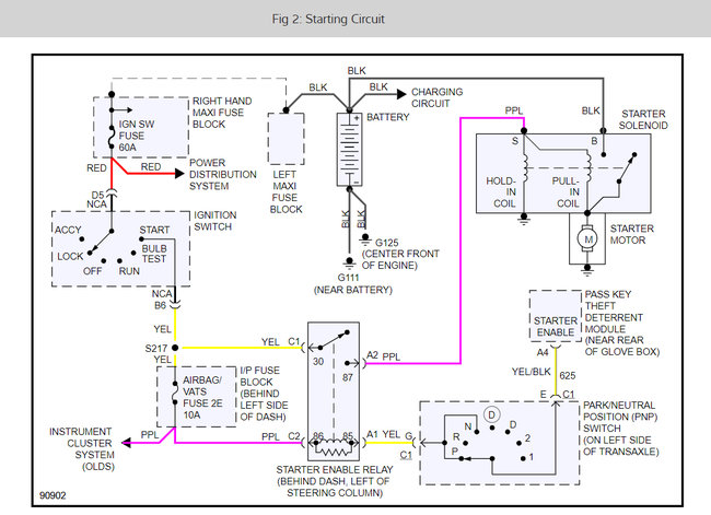

Car failed to start, found starter had an open on the field windings. Replaced starter, no improvement. Haynes manual schematic shows a starter enable relay in the circuit. I cannot locate this relay to check it. It provides the 12 volts to initiate the holding circuit to allow the starter motor to turn the engine. I need a location for this relay and any other suggestions about this problem.
Friday, July 21st, 2006 AT 8:18 AM
17 Replies
MIKEYBDMAN
  • 623 POSTS

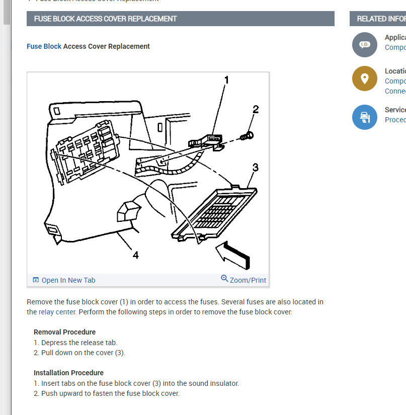

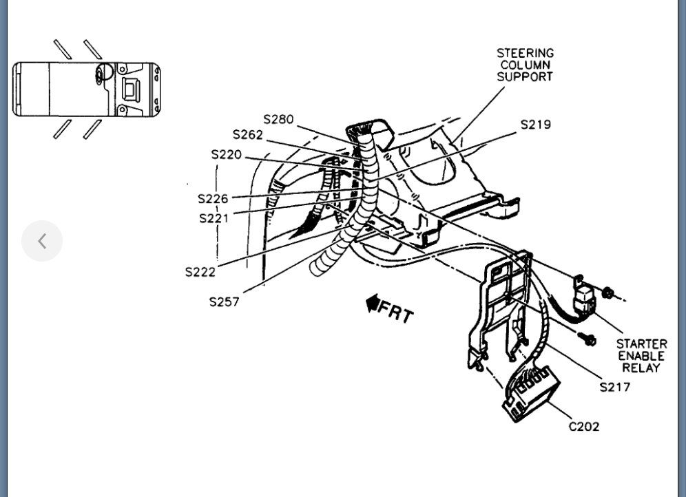

Under the left hand of the instrument panel, above the instrument panel fuse block. Look just left of the steering column support and on a bracket beside the main wiring conduit. You will have to remove the fuse block cover and panel.
Starter Enable Relay Behind left side of dash, left of steering column.
This guide can help as well:
Here is the starter wiring diagrams as well. Check out the diagrams (below). Please let us know if you need anything else to get the problem fixed.

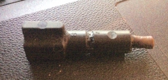

I replaced the starter with attached solenoid. Unfortunately I broke the connector on the small wire, not the battery one.
Can I just get a copper crimp on ring terminal and crimp it on the end of the cable? Concerned that the piece shown has something important in it?
Wednesday, November 18th, 2020 AT 8:13 AM (Merged)
  • 109,816 POSTS
Yes, you can do what you suggested. However, make sure you get a quality part and replace any covering the original wire may have to eliminate the possibility of a short.
