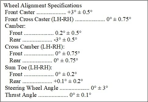

What is the spec for the camber on the front end?

Alignment/camber front end.

0.2 degrees. I prefer to set my computers to read to two decimal places for more accuracy, but this is what GM; provided.
Image (Click to make bigger)
