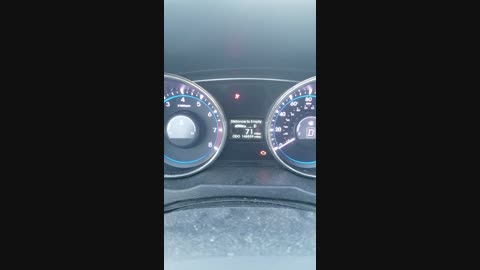

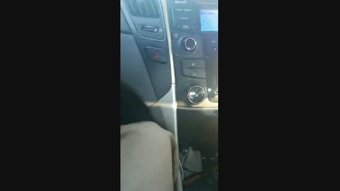

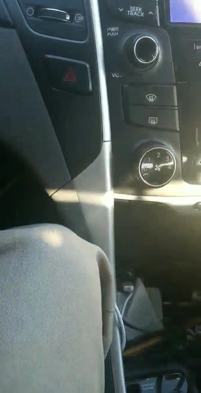

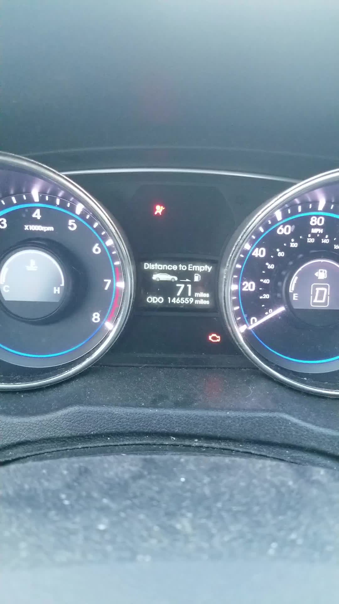

Well my car has got to the point where it isn't shifting right at all. The knocking continued. I even took it to an NTB and the lady refused to service my vehicle due to "liability" last night. I was furious and now I'm not sure what to do. Today I have to call around to see if other place are going to say the same thing.
The videos are different times the one of the dash shows my miles to empty changing. The second let's you hear the knocking while I'm driving. Upon accelerating it is sluggish and the knocking got louder. Again, now since last night anyway, the car is super hesitant and is pretty much not safe to drive on highways.

P0014 - Camshaft Position B - Timing Over-Advanced (Bank 1)
Sort of expected this one. It means that the cam positioner has stuck fully advanced. As such the engine is running in limp mode with low power. The knocking could be caused by this if the valves are staying open far enough that they are hitting the pistons. More than likely the timing set will need to be replaced and the engine checked to see if there is valve damage. If there is and it didn't do any other damage then a replacement cylinder head and the timing set along with it's related parts would likely repair it. However with 140K on it you might be better off replacing the engine with a lower mileage unit. It might be cheaper in the long run.
Both of these are related to the brake light switch being faulty. Seems they still haven't got ones that work right as these have been subjects of numerous recalls over the years.
C1513 - Brake switch error
P0504 - Brake Switch A/B Correlation

Yeahhhh that's definitely not a good sound. And I'm not too surprised about NTB not wanting to touch it. They generally don't want to touch cars that are making knocking noises because they don't want to be blamed for an engine kicking the proverbial bucket shortly after leaving their store. Hence the "liability" avoidance.
