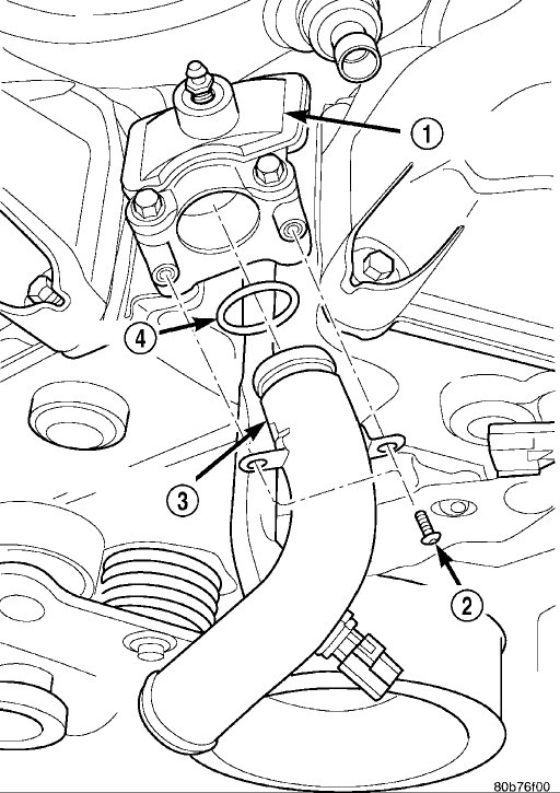

Hi, I got the codes they are P0325 Knock Sensor, P1281 Cooling system Performance and Bank 1. Are these major or minor problems? I really hope minor :) Thank you for your help!

I do not see no code P1281. But for cooling system performance codes usually low coolant will cause this. Check the water outlet housing for leaks. Very common failure on this cars. See image below. It is #1 Also water pump leaks. The water pump is behind the timing chain cover. There is a weep hole behind the A/C compressor. If you see coolant there it is going to be an expensive fix since the timing chain needs to be removed. Also inspect radiator and hoses. If all ok then the thermostat is faulty.
For the knock sensor code. The intake manifold needs to be removed. If the harness is ok then replacing the knock sensor should fix the problem.

The water pump and timing chain were replaced in April 2016. Could the thermostat cause this problem in the cooling system? Thanks for your help, really appreciate all your comments.

If there are no other leaks then a faulty thermostat will set a cooling system performance code. So replace thermostat, replace knock sensor if no damage to the knock sensor harness and clean the throttle body.
