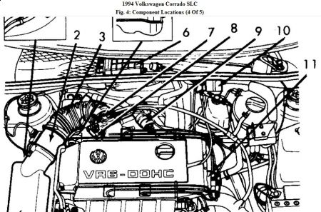

Yes, the codes sure would be of use. I have the descriptions here but not all these might be the cause so to be more accurate, did you erase the codes? If not, try erasing them and recheck codes again to see if all are repeated.
00513 (2111) Engine Speed Sensor
Open Circuit Or Loose Or Faulty Sensor.
00525 (2342) Oxygen Sensor
Open/Short Circuit To Ground Or Battery Voltage
00537 (2341) Oxygen Sensor Regulation
Control Limit Exceeded Or Not Reached
All the codes retrieved, except 00525, does not seems to be the cause of the problem but rather the problem is causing the codes to appear.
If after erasing the codes and they all do not appear while the engine is still surging, check for a stuck or faulty Intake Speed Control valve, item # 9 in diagram or a dirty Mass Air Flow sensor, item # 2.
Using carb cleaner to clean both items might help.
https://www.2carpros.com/forum/automotive_pictures/192750_ISC94Corrado_1.jpg
00561 (2413) Fuel Mixture Adaptation
