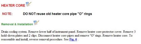

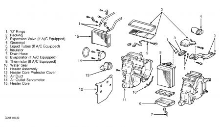

Where is the heater core located?
Sunday, December 28th, 2008 AT 8:57 PM
MHPAUTOS
MECHANIC
31,937 POSTS
Hi there,
The heater core is located with in the heater ducting box under the middle of the dash, see pic
