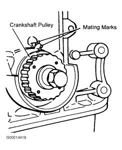

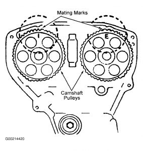

I need a diagram to replace a timing belt for a 1998 kia sportage 2.0 L thank you

Hi there,
set timing marks as per pic's.
Mark (mhpautos)
