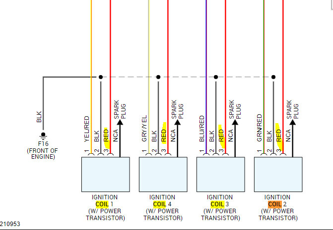

Crank no start no pulse at coils.
Thursday, May 16th, 2024 AT 9:17 PM
2 Replies
PECAN
Getting no pulse at coils.
Friday, May 17th, 2024 AT 11:45 AM

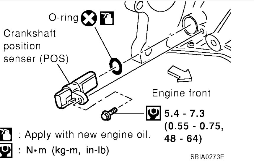

The first thing I suggest is this. If you have a live data scan tool, see if there is an RPM signal when cranking. Or see if the tachometer moves at all when cranking. If there is no RPM signal, suspect a faulty crankshaft position sensor.
This sensor is located slightly behind and above the starter. I attached a pic below.
If that isn't the issue, we need to check for power. Each coil will have a red wire at connector pin 3. With the key in the run position, confirm there is battery voltage at those wires and let me know what you find.
