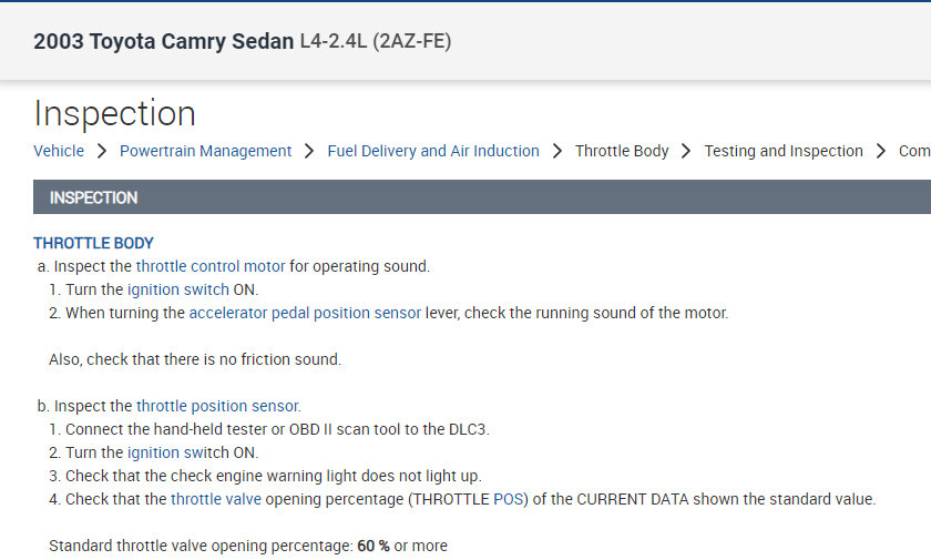

I replace the throttle body my car won't start but if I unplug the connector to the throttle body car start,
please I need to know now the relearn for this vehicle
Sunday, March 10th, 2024 AT 9:48 AM
  • 108,407 POSTS
I checked two manuals and neither indicates a relearn procedure. So, I attached a test used to diagnose issues related to the throttle body.
Take a look at the directions below and let me know if you are comfortable performing them.
