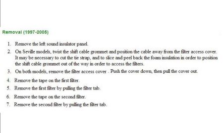

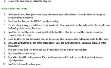

How do I install a cabin air filter?
I do not have manual. Are there any instructions vi ae-mail?
Sunday, October 11th, 2009 AT 9:17 PM

Sunday, October 11th, 2009 AT 9:22 PM
